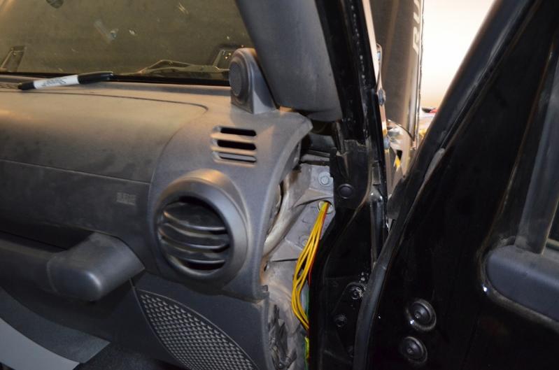

Old Oct 18, 2012 | 06:18 PM
Cheemsaf's Avatar
Posts: 127
From: NM
Name:	DSC_0549 (800x530).jpg
Pic of the passenger firewall access
