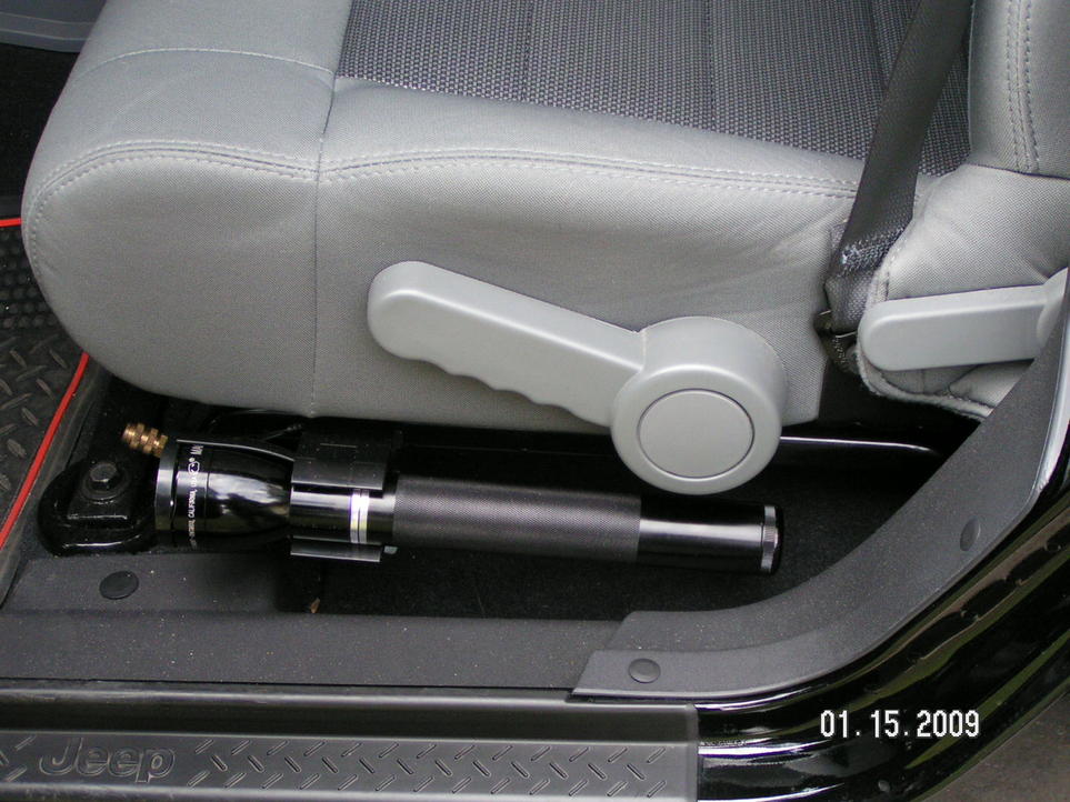

If you are using a maglight magcharger there’s nothing special in the lighter plug not even a fuse, I just removed the plug and wired to the back of the lighter socket with switched power, I do recommend putting a fuse 5 Amp in the red wire to the charger as close to the lighter socket as you can, I mounted the charger on the side of the seat frame using 2 stainless steel rivets, Holds very solid and clears the seat and door.
