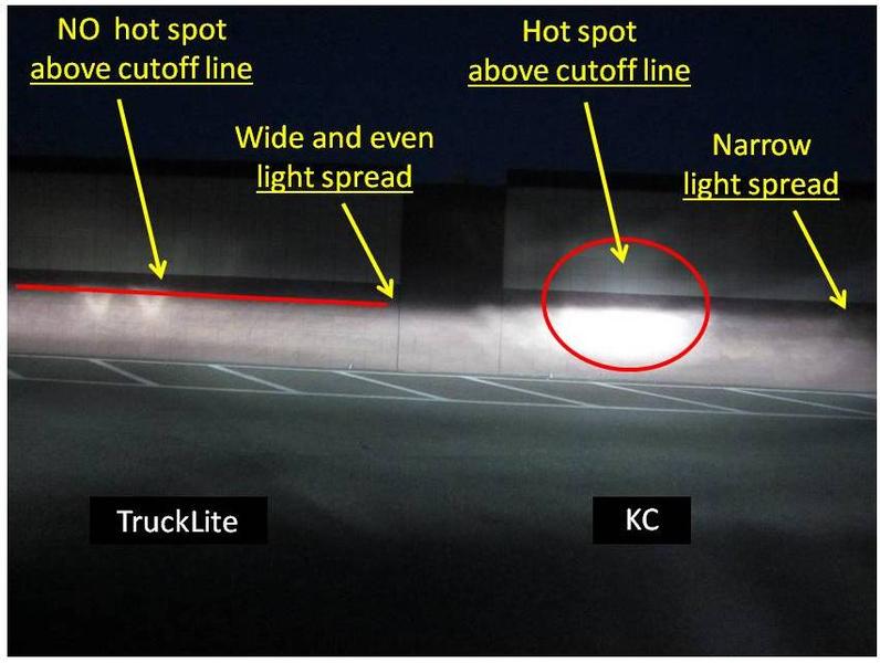

Someone here said - "JW by far. Even spread, no hot spots. perfect...."
Headlights with "Even spread, no hot spots", do not exist.
Every headlight, LED or non-LED, has hotspots.
Both KC and JWSpeaker have prominent hotspots (they're pretty similarly made).
TruckLite have the smallest hotspots -- the small 'x's. Other than that, the spread is more even (and wider than KC or JW, so you see more of the road or trail side), and the cut-off is a very straight and horizontal. This allows aiming the whole wide light spread a bit higher that with KC or JW, as there's no hotspot above the cutoff line to blind on-coming traffic. The high beams are a joy.
KC vs TruckLite - LOW beam:
Name:	KC vs TruckLite - LOW beam - JPEG.jpg

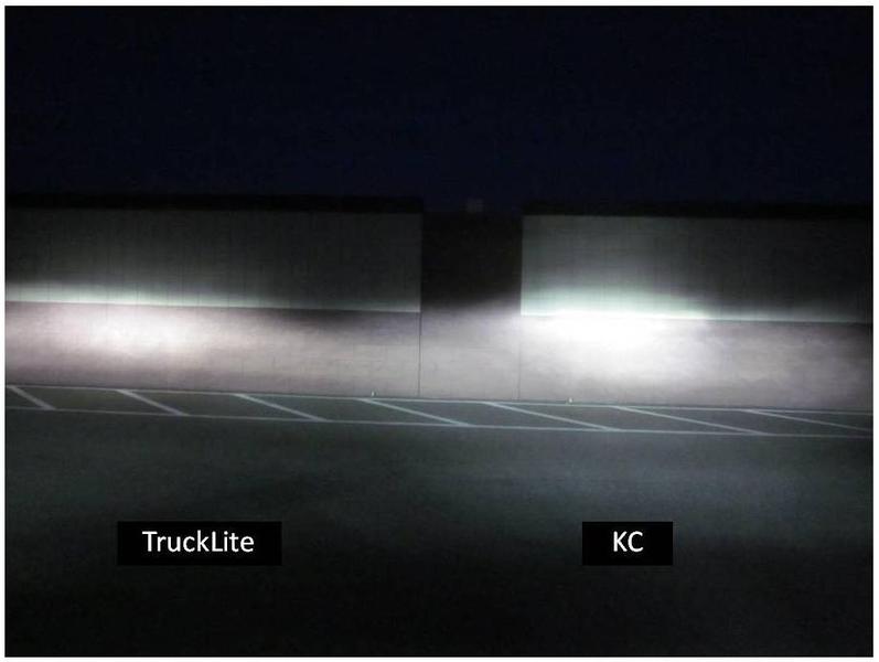

KC vs TruckLite -- HIGH beam:
The KC's light pattern is more like spots than headlights.
Name:	KC vs TruckLite - HIGH beam - JPEG.jpg
