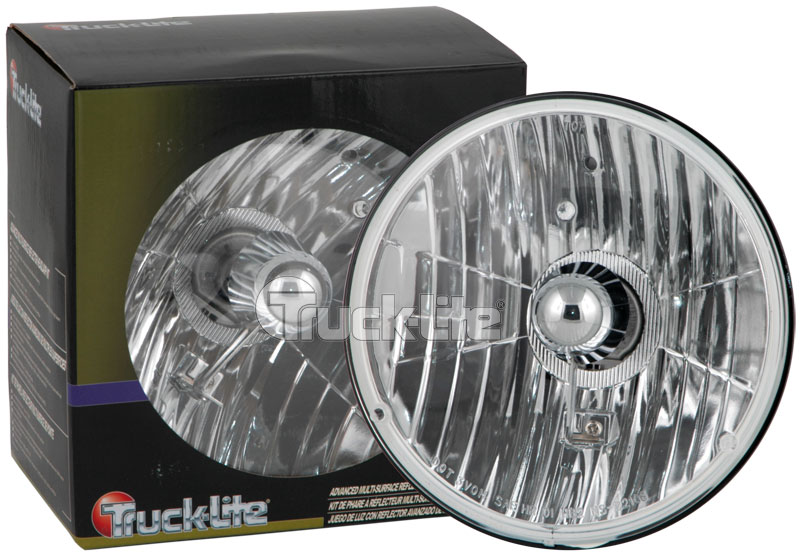

Anyone ever try Trucklite 7"Bulb Replaceable?
http://www.truck-lite.com/webapp/wcs...8751&langId=-1

The IPFs through a brighter light then stock but the output is bad. You loose a lot of light out to the sides. There are a lot better options out there cheap and one of the best fixes is the cibies with a good bulb. You can buy them at places other then DS.
The next best or first best depending on how you look at it is JW Speaker long life and the light output is almost as good as the cibies. Trucklights are coming out with a new product if you want them I would wait as there current version is not as good as the above for light output.
Google this stuff off the forum you will find some light shoot outs that show why I say the above.
Stay away from HID bulbs in your stock housing it just makes driving harder for others on the road.

Originally Posted by Riptide
Unless that's their new LED light, there's really no reason to even consider it. The chances of it being better than the Cibies or Hella's are pretty low. And while Cibies might be out of ones price range, a set of Hella's is like $80. There's really no reason to look much further unless you're looking to test them.
$ wasn't the concern, there are so many 7" lamps out there...curiosity getting the better of me..., it sounds like Cibies are the ones for me.
