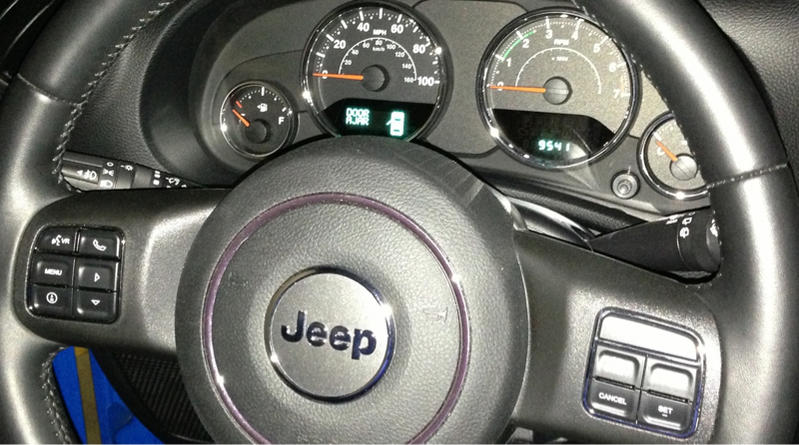

Really ???
To the OP look at your steering wheel. The bottoms on the left side do you have the phone and VR button ?
Also when your door is open do you get a message under your speedometer "Door Ajar"
If yes to both then your JK Came factory with the connectivity package
