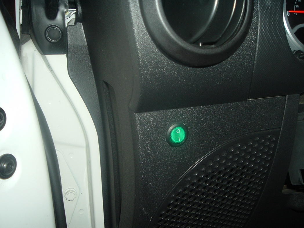

I sized the back of the switch to a 1/2 drill bit and the switch was bigger. its not a treaded back switch, it looks like a press fit switch. it looks like this.

I used a 1/2" and had to wallow it out a bit to get the switch to fit.
Name:	Windshield Light Switch.jpg
