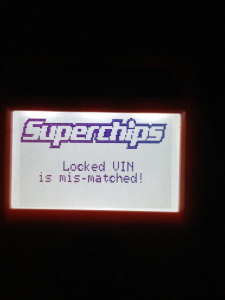

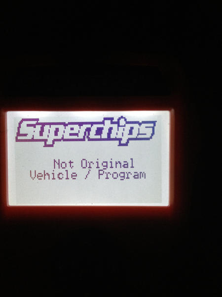

Bought this Superchips Flaspaq off of a guy on the forum, plugged it in and this is what it says. Called Superchips but they're closed. Can anyone tell me what a G-37 code means!?

That means he never took the tune out of his jeep and his vin is locked in it.
Old Mar 14, 2012 | 10:03 PM
MortuaR's Avatar
Posts: 392
From: Cibolo, TX
Yeah, from what I understand that tuner can only be used on one vehicle at a time. He would have had to 'un-tune' his Jeep before he sent that to you. :(
I really hope superchips can help you out. Else you'd need to get it back to the guy to un-tune his Jeep or refund your money and hope he isn't scamming you...
Old Mar 14, 2012 | 10:06 PM
Mark73's Avatar
Posts: 460
From: Windsor NS
Superchips will unlock it for 100 bucks
He might of tried to un tune and missed something stupid like tire pressure setting speedo correct everything has to go back to stock

You used to be able to do it online. Connect your SC to your PC. You should see an option to unlock it from previous VIN. Pay the $100 with credit card and in 3 minutes you'll be good to go. Or that's how it used to work...

The guy I bought it from took care of everything!!! Really a stand up guy!!! ::two thumbs way up::
