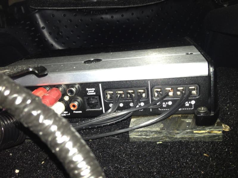

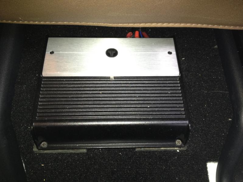

Here is the amp and deck. Speakers are the JL Audio 6.5"

Hmmm. All black speaker cable.... Is it possible a + - got mixed up on the back of one or both of the speakers? Just a thought.

Little Fella,
Does it matter? I'm not too sure it makes a difference. I am too dumb to have the answer to that.
