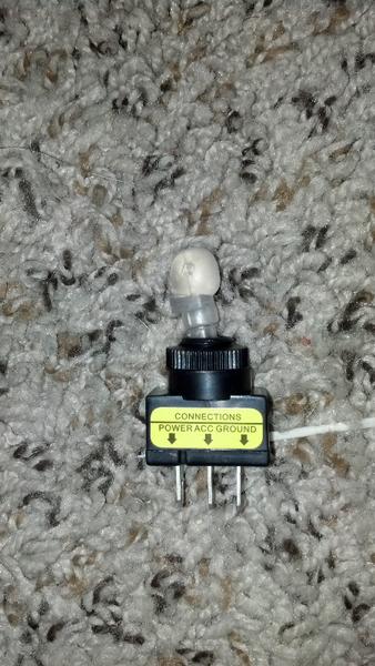

So im installing my lights but not too sure how too i bought a toggle switch but idk what to plug on what!(:
There are 3 pins a ground, acc, and power what do i plug to what thanks

Here's the toggle switch

Ground goes to a ground on your body the acc is the power wire to ur lights and the power goes to 12v i think

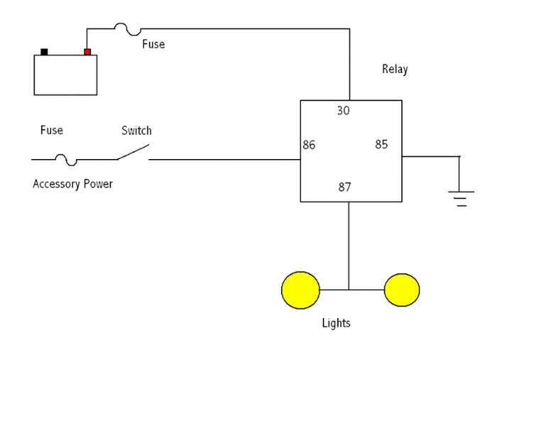

Relay is something that will regulate the power going into your lights as to not mess up the computer in your jeep it would be smart to get one & wire your lights through the relay I've got some extras I could send you one with a diagram if you'd like

Here's a diagram

Im really new to where can i buy them i have my day off tomorrow so i want to finish it do you have pictures of the relay?

You can get them at most any auto store ill find a picture of one

U can get a wiring kit at 4wheel parts it comes with wire, a fuse, a relay, and a switch plus it has that diagram on the package....
