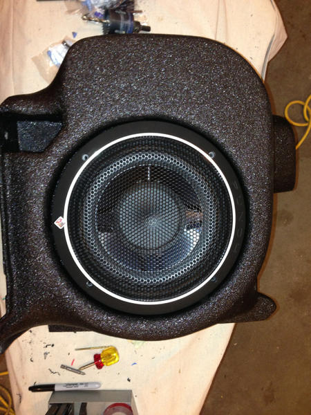

If your 12" is a shallow mount you may be able to pull it off. My first sub in my 2013 was a modified stock enclosure for a 10" shallow but it only required .5 cu ft. Most 12" shallows require 1 cu ft so you would have to modify the crappy plastic enclosure and make it larger by fiberglassing and expanding outward (which would obstruct your rear storage) or upward (which would make the box extend above the back tub)
Here"s the 10" enclosure I did. It sounded good with the hard top on but disappeared with the top off. I sold it and went a different direction. I ended up putting two 10" subs under the front seats. Great for top off summer driving.
Attachment 490512
