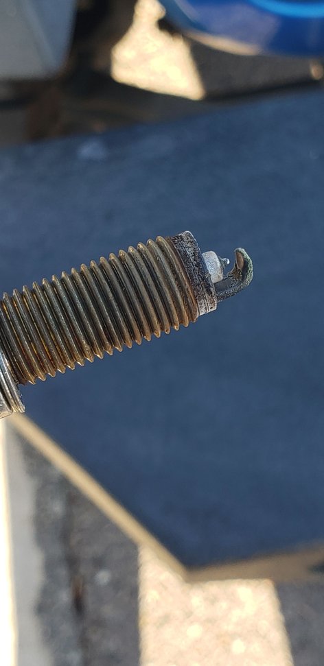

Anyway whats odd is I ran seafoam thru a tank and the new cel is for #5. So I decided to check the pak and plug, plug definitely needed swapped so I also replaced the pak, drove her a bit and it ran like crap then fine, total of about 10miles stop and go and a few hills, straightend out and was running like new, the next day the wife called and it was throwing a new cel and running like crap, shaking etc halfway thru her 15min drive to work. The new code is now #5 injector circuit and obviously #5 misfire.

Plug #5
Plug #5
. Thanks in advance.

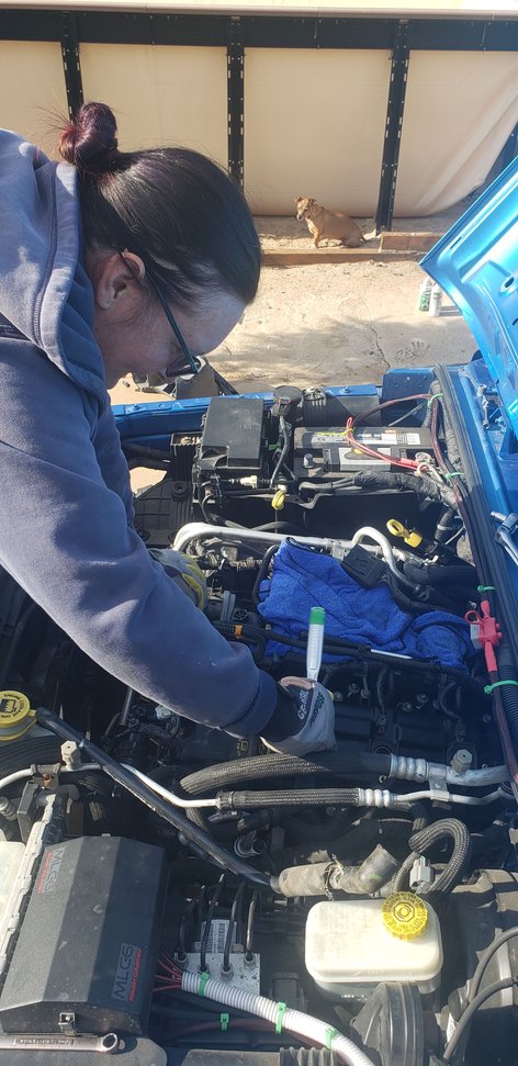

2 days and the valve cover and PVC have been corrected and all injectors removed.. had the misses working on her jeep as well.. lol after her manicure and nails, my wife is awesome.
So tonite I will be cleaning the injectors using a Schrader valve my power supply and carb cleaner. Also washing up the O-rings. I'll will post agian with how it all went.
