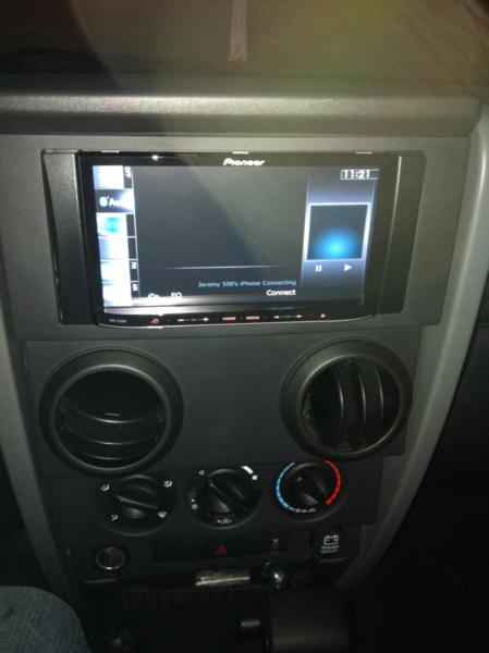

I just installed a pioneer Avic-z120bt this week so if you get stuck on your install shoot me a message.

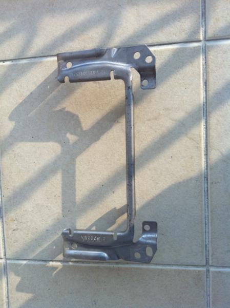

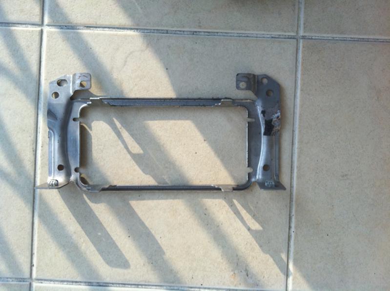

Not to hard overall only problem is cutting the factory bracket if you are installing a double din

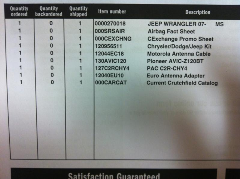

Also attached a list of items I ordered to make the install east pm me for the site since nor sure I can put the name.

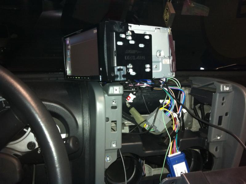

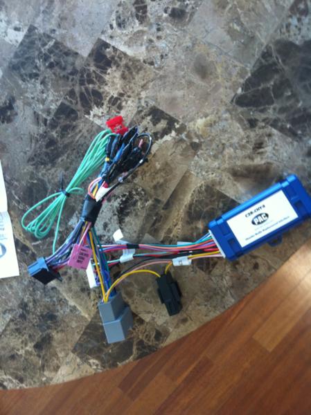

Lastly I added a pic of the wire harness all connected ( I like tape so no need to say you should have used wire connectors)
