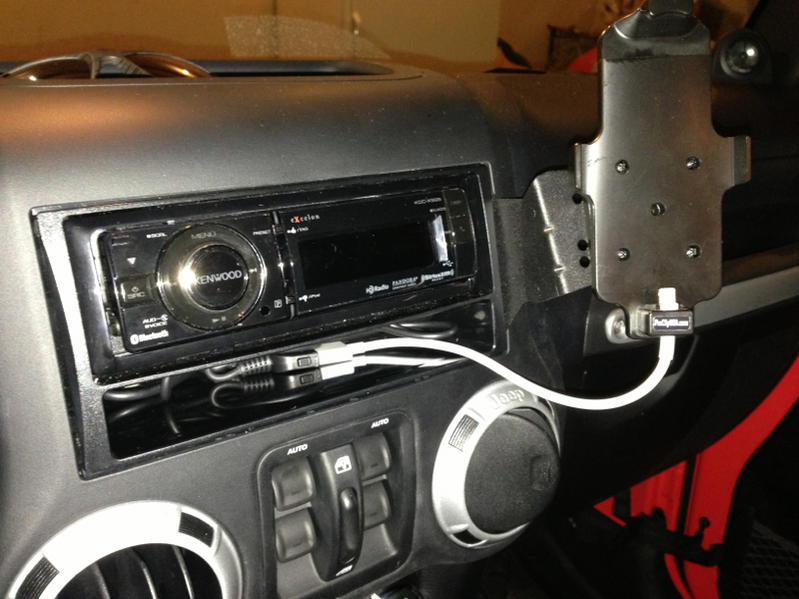

I have the phone on a mount right next the the head unit. Click image for larger version

One think I do not like about the Kenwood, but I think this is the case with virtually every head unit. When you plug the iPhone into the head unit, I no longer can browse music on my phone. I can use all the other phone functions and apps, just not the iTunes. That is controlled by the head unit.
