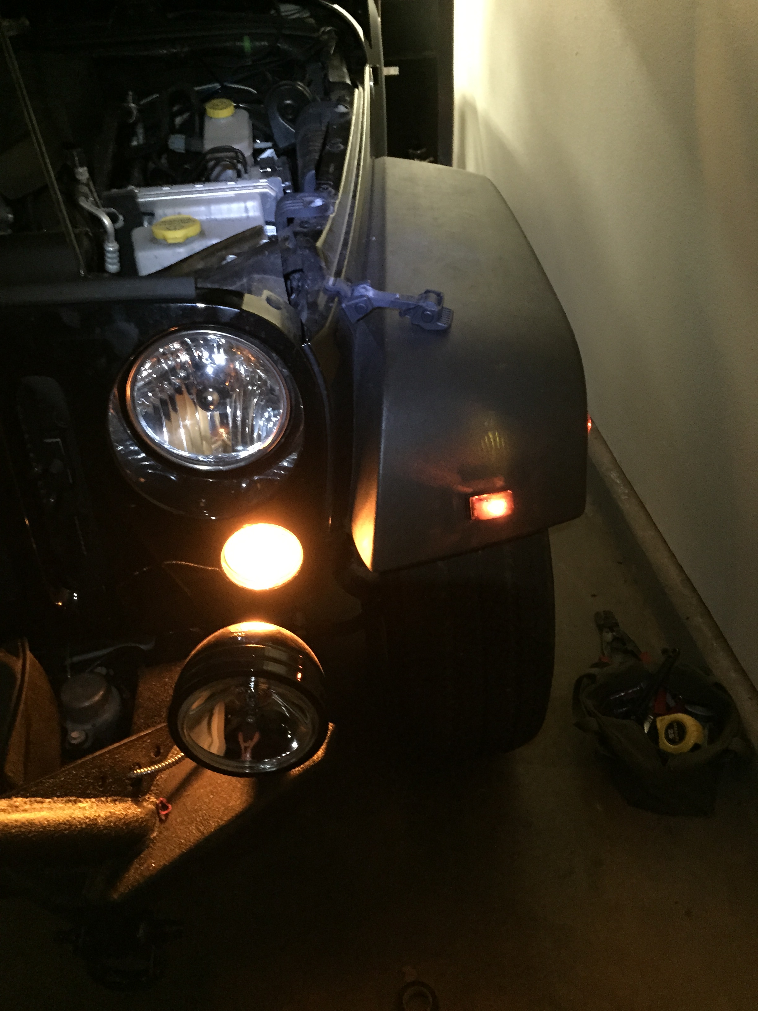

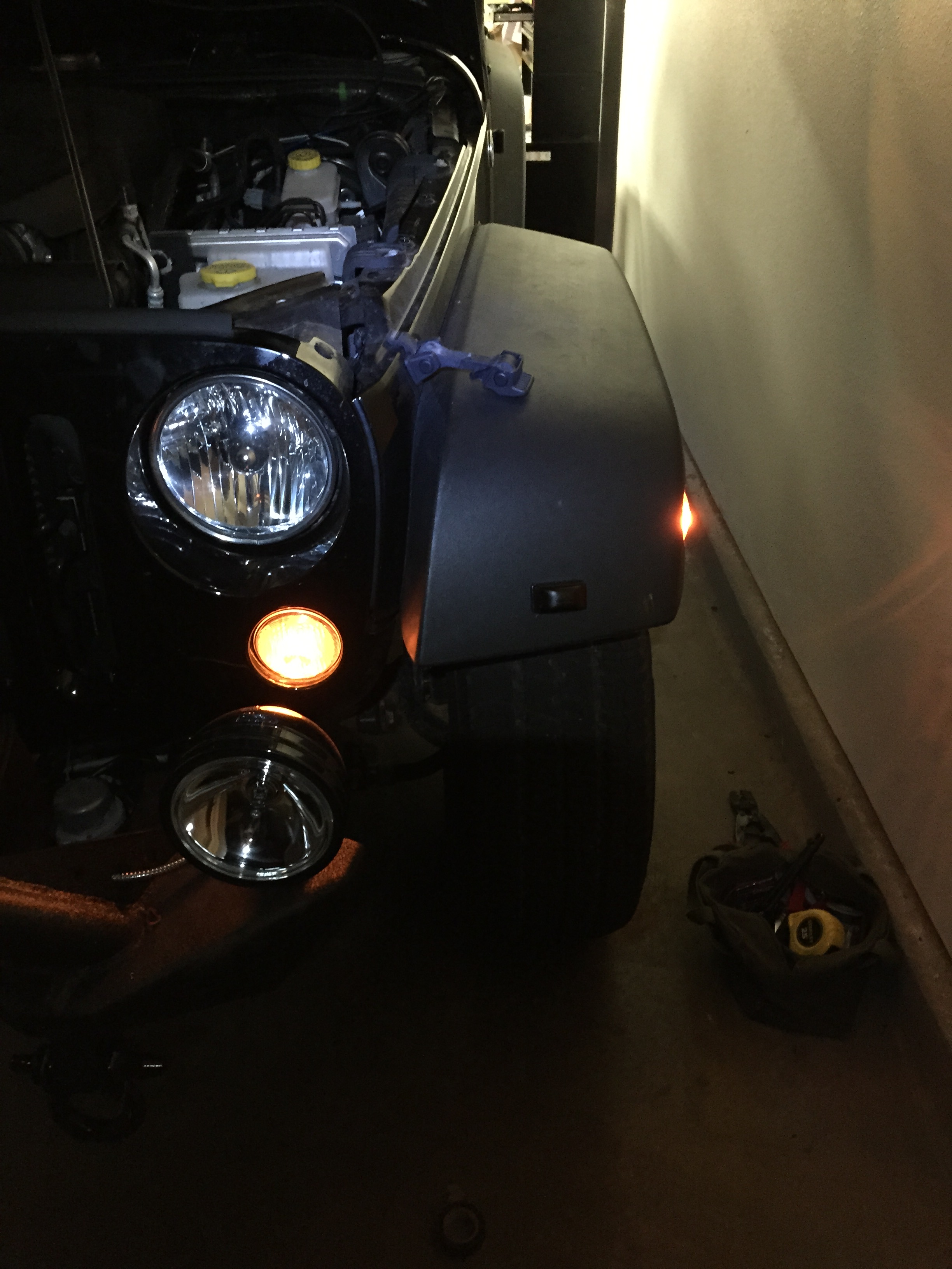

ok so all done with the install. pretty straight forward: drilled a hole to mount the lights and a smaller one to run the wire. i ended up doing the side marker turn signal mod as well, so i tapped into the same black wire to run these. i chose a slightly different light merely because the orginals were too rectangular for my taste. i also sprayed a single coat of vht nightshade on the lights. its just enough to hide the amber lens but doesn't affect light output. all in all i am pretty pleased with how they turned out, and i believe they have achieved the desired result. they can be seen from head on night or day and allow oncoming traffic to see my turning intentions. so here are some photos of the finished product.

Problem solved. Good job

So tap the black wire? I'm thinking a few of the 3/4" in the front bumper to get a nose out in traffic and show people where I want to turn. Rears for brake lights will be easy but same concept- increased visibility since I'll admit to spending most of my time on the road.
Old Jul 7, 2015 | 08:55 PM
yellowtj02's Avatar
Posts: 401
From: Wahiawa, HI
I tapped the black wire cuz I did the side marker into a turn signal mod. If you want to tap into the factory turn signal, tap into the bottom wire coming off the factory plug. White & grey for driver side and white & green for passenger side I think.
