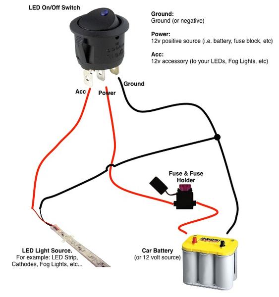

Default Wiring to your battery
I think this is a good diagram.

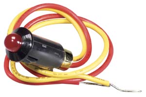

What guage of wire would be good to use if you are splicing into the 12V outlets?
on the LED that i found that say 12V, 30mA, it has a 24 AWG wire on it but it just seems so thin. The thing with this light is that it has a resistor on it already. so it will have to stay in the plastic housing it came in. The LED wire leads are super short as it is. So i am thinking of putting these under the vents and above the climate controls. just some ambient lighting and maybe a couple red ones down under by my feet.
At the same time as the red ones, i am going to install a second circuit with white lights that are a little more usable when finding things.
