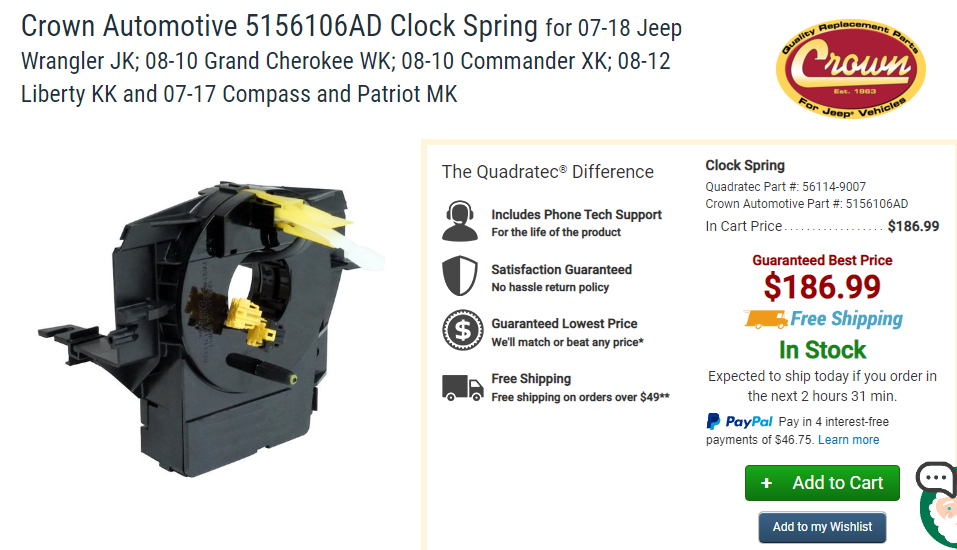

Interesting - is the a Mopar to Crown clockspring part number cross reference? Or can you point me to a supplier for that part?
Thanks, Simon
Old Dec 14, 2022 | 08:31 AM
resharp001's Avatar
Loved
Community Favorite
Joined: Jun 2013
Posts: 11,363
Likes: 2,089
From: Willow Park, TX
Highly certain this is what I used -
Just grabbing the snapshot off first retailer I pulled up so I'd search around on the part number. years back when I replaced mine that same one was ~$130-140 I think. Everything has gone up in price.
