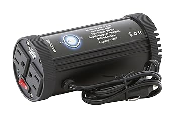

I've entertained the idea of an inverter a few times. Every time I've thought about it, seems like the idea was fine as long as you're moving and the jeep is on. As soon as you stop, you start killing the battery. To run such small things, I ended up just doing a little portable inverter via the 12v power plug. The time/effort/cost/space to do a nice semi-permanent install with a real unit was just not worth it, at least for my use. Maybe if you were overlanding all the time it would be.....but I still question how people with fridges and that kinda stuff keep their battery(ies) from dying.
I gave up and just got this for $14....and it sits in my cupholder when needed.
