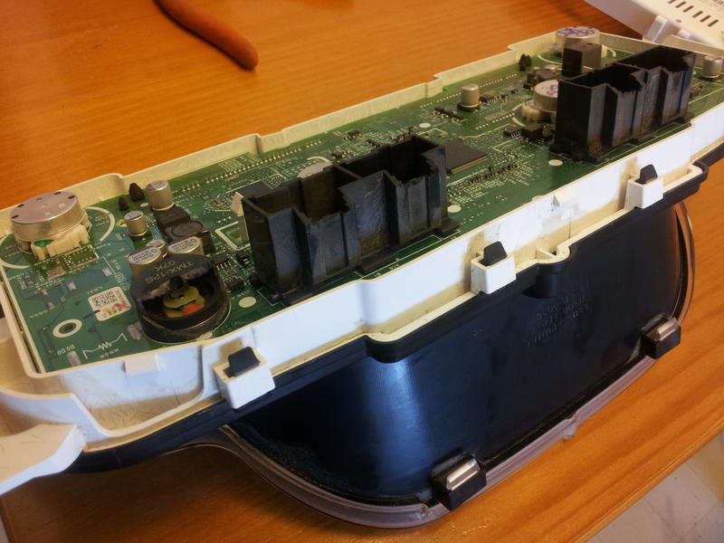

With the rear off you will find the source of all of this stinking DINGING.
It is a small metallic transducer, speaker, in a black plastic housing. You can either:
1. Take a small piece of earplug and insert it firmly into the opening in the housing
Name:	JK Chime Removal (2).jpg
OR
2. Destroy this noise maker FOREVER!!!
Name:	JK Chime Removal (5).jpg
Personally I went with the latter.
