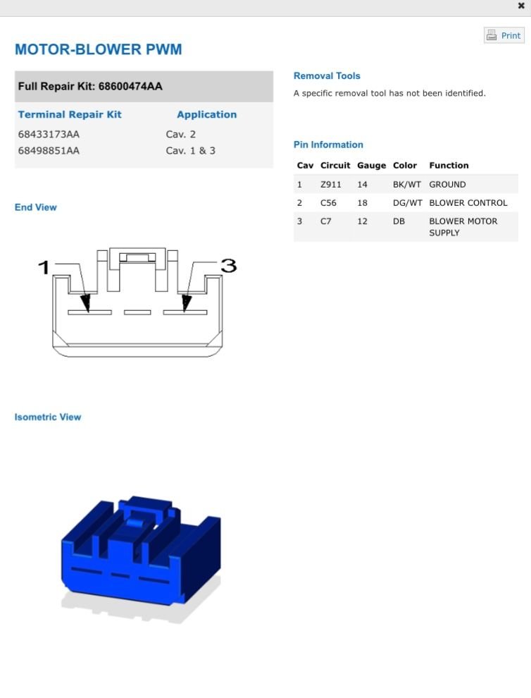

As it seems common in many of these posts here, my blower motor was going out in my 2016 JKU Sport S and caused the 3-wire connector to burn. Finding / replacing the motor is easy, but I can't seem to find the 3-wire connector for the JK. Tons of posts about the TJ, but none for JK. Any help would be greatly appreciated.

Like that?

nobody has an image of ether of those parts but
https://www.moparfactoryparts.com/oe...ing-68433173aa $25.05
https://www.moparfactoryparts.com/oe...ing-68498851aa $44.62
