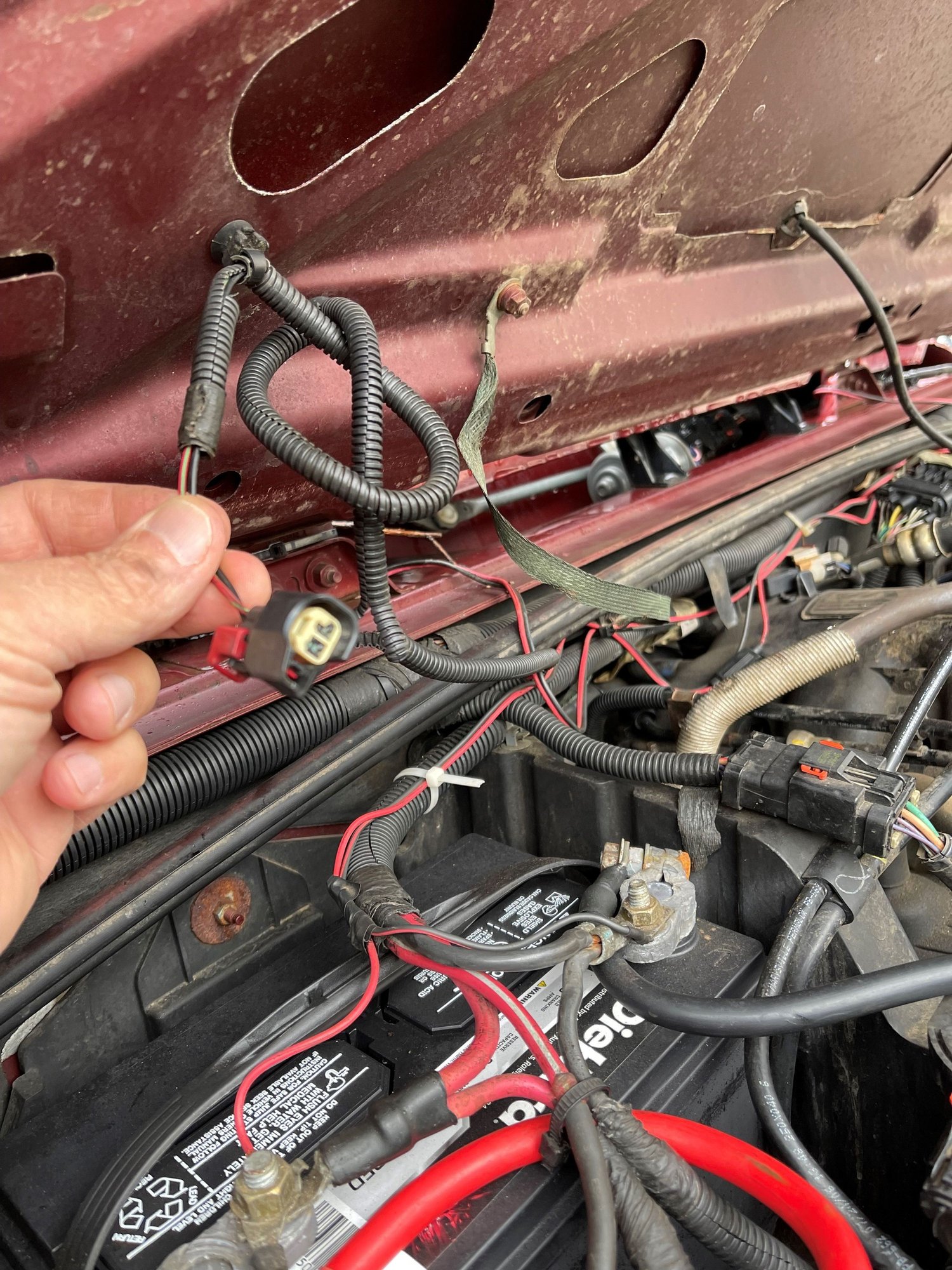

I recently purchased a 2007 JKU. I am struggling to get the O2 Sensors corrected.
But I found an empty plug under the hood?
Can anyone help identify what this is and where can I find the other end?

That's for the underhood lamp. Looks like the previous owner ditched the lamp. They did have a bit of a reputation for not going off when the hood was closed draining the battery.
That connector has 12vdc hot on it. I'd seal the end or remove the M11 fuse (if it's still there).
