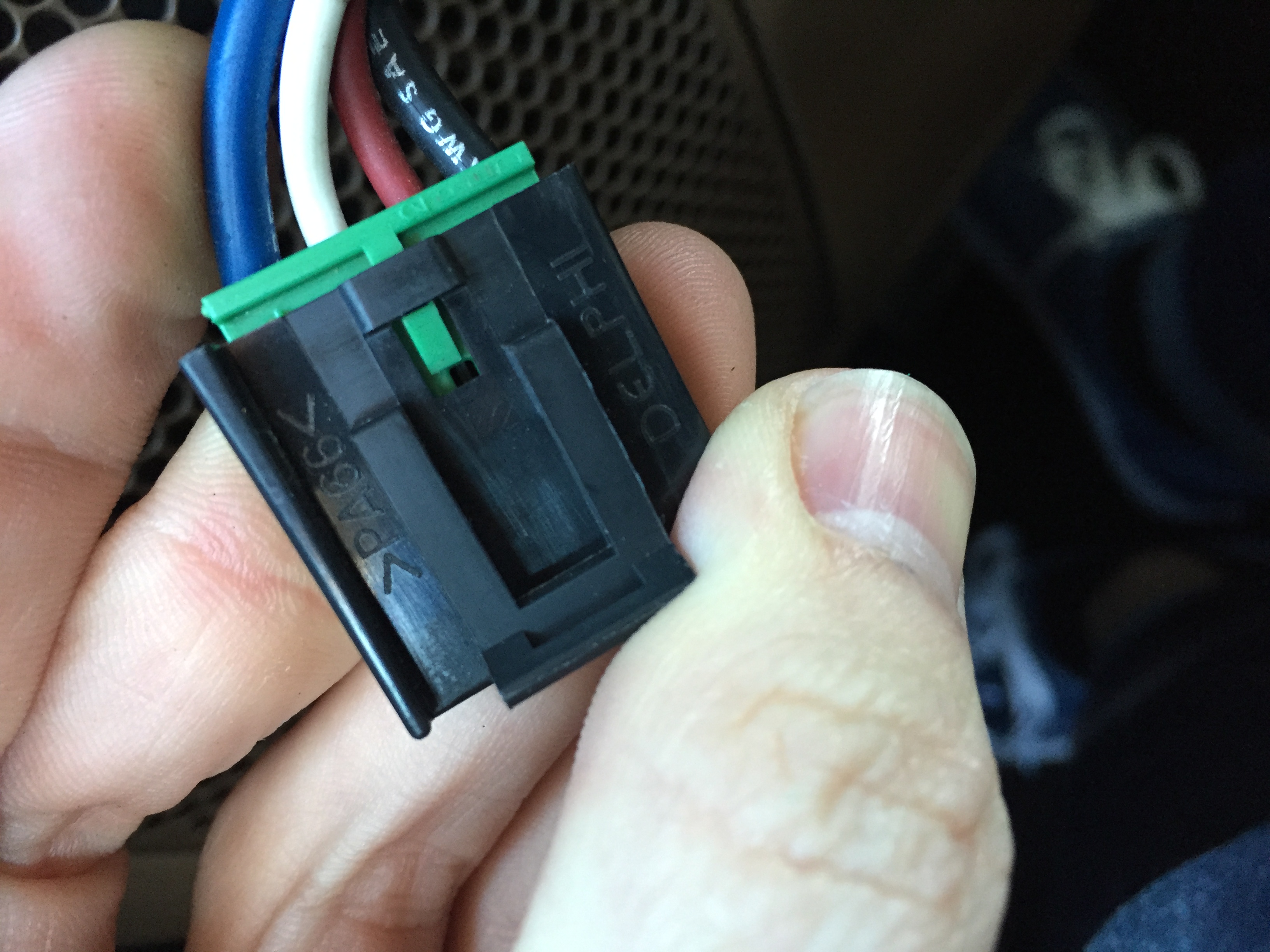

So I just bought a 2011 JKU Sahara and have been fooling around trying to figure out all of the buttons and everything on the dash. One thing I'm having trouble with is trying to get my dome light to go on when I open my door but it doesn't seem to be working.
I'n search of trying to figure this out I found an odd looking wire harness routed under my steering wheel and I have no idea what it could be for? Here are two pictures I took of it in hopes one of you more advanced Jeepers can help me out.

Also, if anyone can help me out with my dome light problem I would greatly appreciate it. I'm thinking it may be a fuse but I don't know where the location of that fuse would be?

With the introduction of the JK series Wranglers they moved the switch that activates the interior lights from the framework to the doors themselves. There's a cable run that has to be disconnected from the doors when you take them off that keeps the light off. Check by the door retention straps to make sure they are all attached.

Check the gauge cluster. I had the same problem in my 2011 jk. The gauge cluster had a short and needed to be replaced. Works great now.
