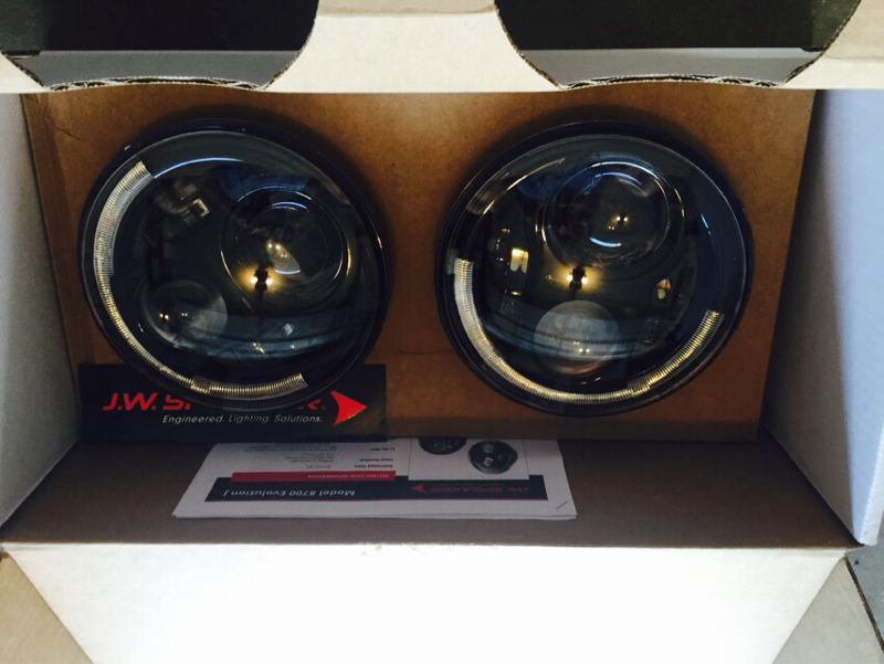

Just picked up these puppies, https://www.amazon.com/gp/aw/d/B0137...?ie=UTF8&psc=1 , after getting the run around with 4wheelparts. Install was way easy and took sub-30 minutes.
Steps in a nut shell:
-remove grill fascia, just 6 pop outs on my 2013 JKU.
-pop off the bottom clamps, just used a flat tip to press down while applying local pressure.
-remove old headlamps, 4 x T15 torx. -transfer bezel from old headlamps to new ones
-connect new LEDs
-mount bezel
-reattach fascia
-Boom, you have light!
From there I found a nice wall, parked 25' away and leveled my lights just below the 3' mark. You'll need a skinny Torx for this, not one of the interchangeable bits ones. There is a more fancier way that has quite a few more steps, but I opted to keep it simple. Just from a vanity perspective the lights look amazing compared to stock and add to that they throw off some amazing light and you have a winner -Tom

Curious that Amazon sent you a set of lights with the led daytime upper half halo on top. Reviews explain this half ring model as being for European JKs specifically and halo-ringless on US models. Even the Amazon photo shows the US version while you clearly received the European style. I know I can't be the only one to come across this (mixed) info. Could you tell us if the half-halo has a separate wire for daytime driving lights?
Night shots are always helpful too for comparison and price justification if any other J 2 series are out there.
According to JW (LED Jeep Lights - Model 8700 Evolution J Off Road Headlights) The Evo J's come with the "... one-of-a-kind look, featuring a cool “half halo” light pipe..." So I am not sure its a correct assumption these are European Specs... not that I would mind.
Of course there could be Evolution 2's, not J series, that have a difference in EU vs US spec. But that is just naive assumption by me.
As far as connecting it up, its just plug and play with the existing cabling.
