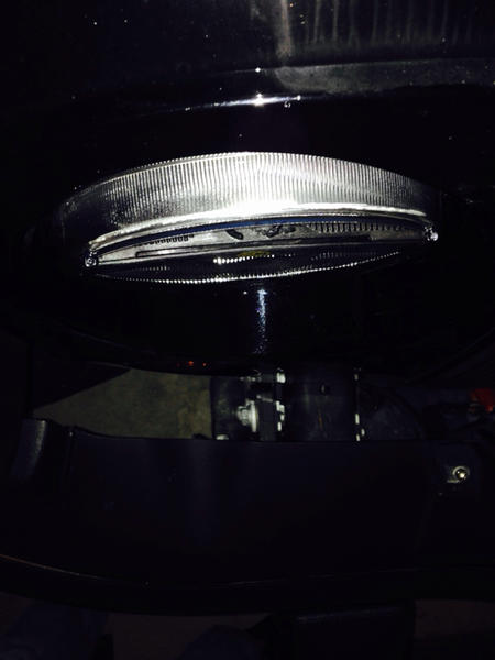

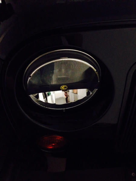

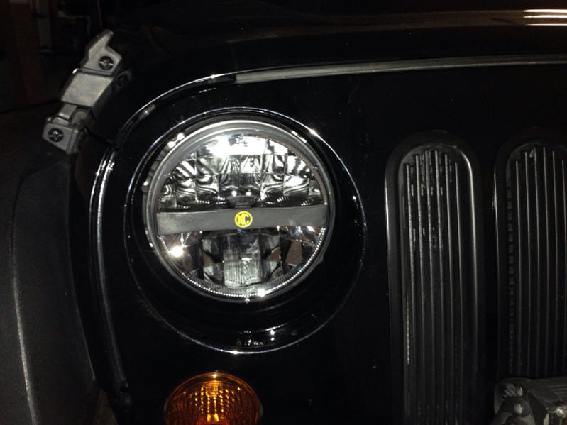

Here are some photos. They seem to stick out quite a bit as well. They are mounted solid in there so I'm not sure if this is right.

No this does not sound right at all.
First of all there should be 3 little cut out things on your factory plastic light mount rings. The KC's will have also have three bumps that stick out and will sort of fit into the cut out places.
The sticking out and looking kind of funny at first is normal. The beam pattern being off is also kind of normal in my opinion as these lights are not the same as the factory bulbs at all.
I highly recommend getting an extra adjusting bolt from your dealer or favorite Mopar parts dealer.
You want part number 1-55078114AA
This extra bolt fits into stand off on your mount ring right behind the cut out on your grill is. Notice how there is an extra groove for an adjustment screw? yeah well Mopar was too F-ing cheap to include an adjustment screw in this location. It is a pretty easy thing to add. First you will have to get the plastic ring to disconnect from the current stand off thing.
I used a small screwdriver and sort of picked at the three little lock tabs while pulling outwards. it did not take much force and if you work around the three tabs all of a sudden it will un clip. Remove this one stand off and discard. The new adjustment screw will now screw right into place. This will allow you the side to side adjustment you need.
Hey I know reference this thread https://www.jk-forum.com/forums/jk-e...8/#post3832638
Thanks to rsmeanie for that little find.
This will allow you to now adjust the beam pattern side to side. Mine was way off for the KC's.
I love these lights. I do not care what anybody else says about Truck lights being better blah blah blah. Whatever these suckers will sear your eyeballs out.

I did see the three tabs however, if this makes sense, the KC seem to have "round" tabs and the stock housing seem to be square so they won't quite push all the way in flush. I did read that thread all the way through and was a bit confused as to wether the housing unit that the headlight goes into has to be removed or if the pegs just pull out. I might just take it to the dealer and have them try to adjust them right. But man are they bright!!

I installed mine yesterday as well. Mine also didn't sit completely flush but the tabs all seemed to line up. I mounted the trim ring and all is well in my opinion. However as far as the horizontal adjustment screw goes why isn't it there already! My passenger side is ok but the drivers side is way off. It's almost like the light is out. So much for plug and play

It's funny because the brights look awesome but the lows are just like yours. Real bright on the pass side but almost nothing on drivers side. I'm thinking the drivers side will need to be adjusted to the left quite a bit to get to separate beams.
