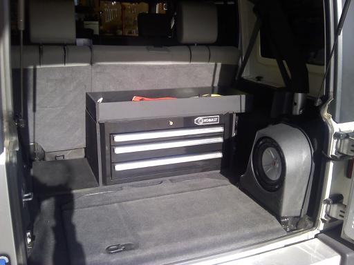

Nice write up! I used a 8" Kicker cvr powered by a 300w amp hooked off of a line out converter. Also made a spacer like you did out of 1/2'' oak and painted it black. With some dynamat on the inside of the box and some foam between the box and tub to hold it tight and stop rattles, this thing moves the mirrors prety good!
<img src="https://www.jk-forum.com/forums/attachment.php?attachmentid=267661"/>
Where did you place the amp?
kinda hard to see in the pic, but it is screwed to the right side of the tool box. I did have it in the hidden storage but it overheated too easily.
