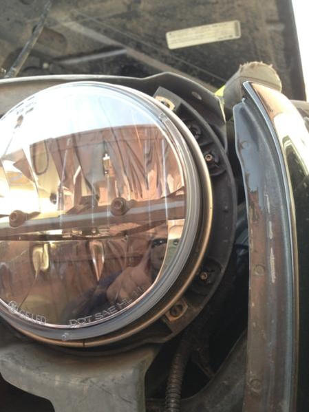

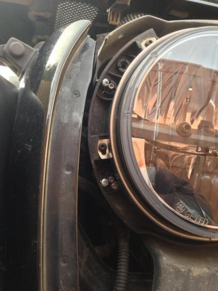

Did you take any pics of your adjustment screws or where you mounted them? My X's are both directly in front of the passenger. I need to adjust both of mine towards the driver. If I take the lights out will I easily see what needs to be done? Thanks.
Old Jan 17, 2014 | 10:33 AM
  #33
chuck_tempe's Avatar
Posts: 58
From: Tempe, Arizona
Originally Posted by bobholthaus
Chuck:
Use a pair of adjustable pliers to "pop" out the fixed studs. Be gentle or you may crack the plastic around where he screw goes and fix it like I had to instead of buying new headlight buckets. It is easier to adjust the lights with the grill off because there is no notch for the second adjustment screw on the grill.
