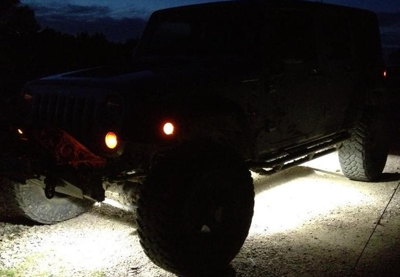

Get on amazon & look up truck bed light or under car light or just go buy some leds & wire them up in your own patter. I used 6 of the small single row lights from blitz pro. The app isn't letting me upload pics right now but when I get home I'll put pics of mine at night up

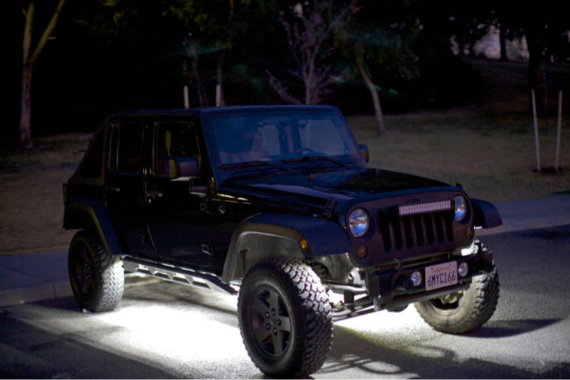

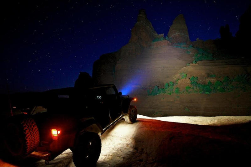

I used A brand called Eco light LEDs
They work great I just went out and bought the switch and fuse and used wire I already had. Super bright.

Those look really cool. I looked on their site though, and it says they're not submersible. That makes me a little worried about how long they'd last if you did some mudding or creek crossings.
How are yours holding up so far? Maybe they could be sealed up with some epoxy.

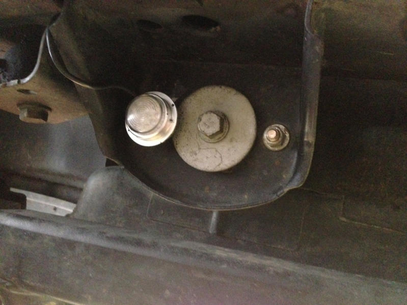

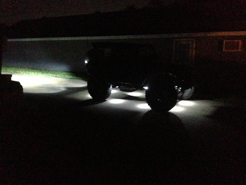

Vision X tantrum in the pics my backup lights are on so minus them
Tack welded 1/2 nut to a 1/2 washer
Epoxy them to bottom or tantrums and spun them onto one of the two bottom of body mount studs.
