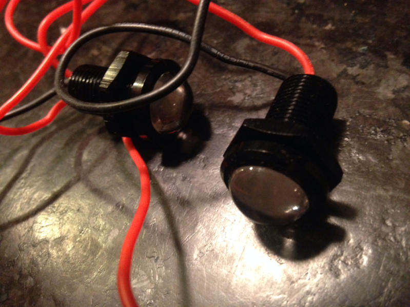

Decided to light up my jeep a bit inside

Dropped the sound bar by removing the 6 alread and two hard too anchors
Old Mar 15, 2014 | 07:46 AM
LAFMO's Avatar
Joined: Jun 2013
Posts: 56
From: Mashpee, MA

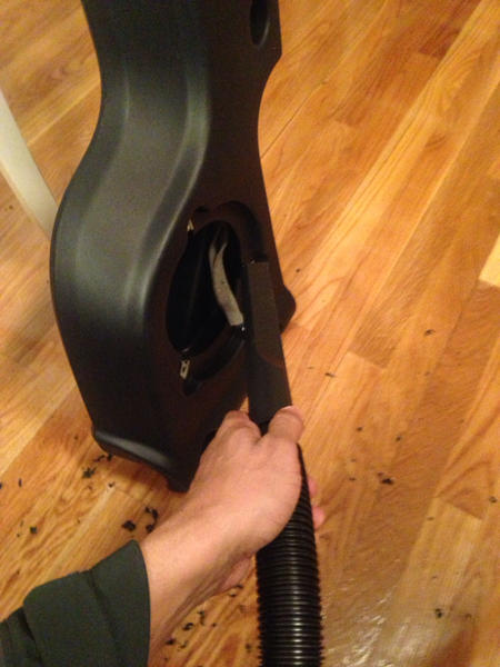

[QUOTE="LAFMO;3861718"]Dropped the sound bar by removing the 6 bolts and two hard too anchors I removed the done light cover undid the screw and pulled the light out to expose the wires. There are three. Brown, yellow with a stripe and solid yellow. The solid yellow is the switch power and the brown is the ground I used to taps to extend a wire off of each. I then drilled the holes " free hand" one size bigger than the lights. I made the rear holes larger to fit the nut on the other side and inserted all 4 LEDs in and tightened them up. I removed the speaker on one side and used a shop vac to remove all the little plastic pieces that fell inside. I then wired all the LEDs to the positive switch and the ground wire so they turn on and fade out with the factory lights. Reinstalled the speaker and then put the sound bar back in.

Where did you get the LED's from.

Super bright LEDs !

Just a little update. the lights re working flawlessly and I believe they offer superior light to any other aftermarket plug and play lights. They illuminate the entire cargo area all the way up to the front of my weather tec mats in the front.
