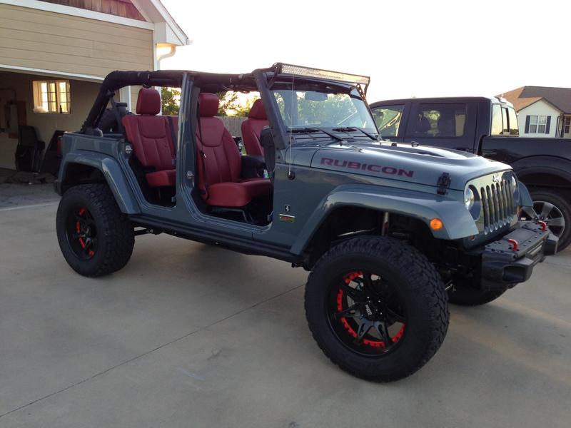

I tried it both ways, black to black and black to red. Still nothing. I bought it from eautogrilles on ebay. I have sent them an email and waiting for a response now. I was really impressed with the fit and finish of the light, wiring and mounts. Unfortunate that it didn't actually light up!

Sorry to hear about the issues. We have a few 50s in stock, let me know if your original vendor doesn't pan out.
BTW... I absolutely love the color combo you've got going on, the seats look fantastic
