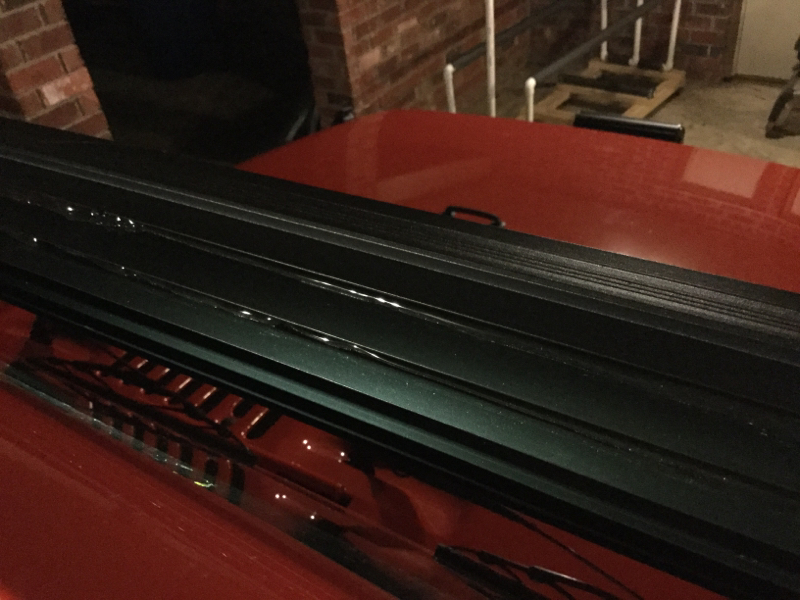

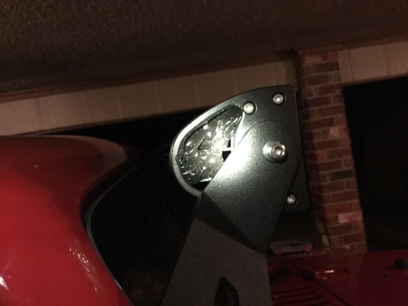

I used black silicon on the sides and then between the top three fins. No more nose.
ID:	660700   Click image for larger version
