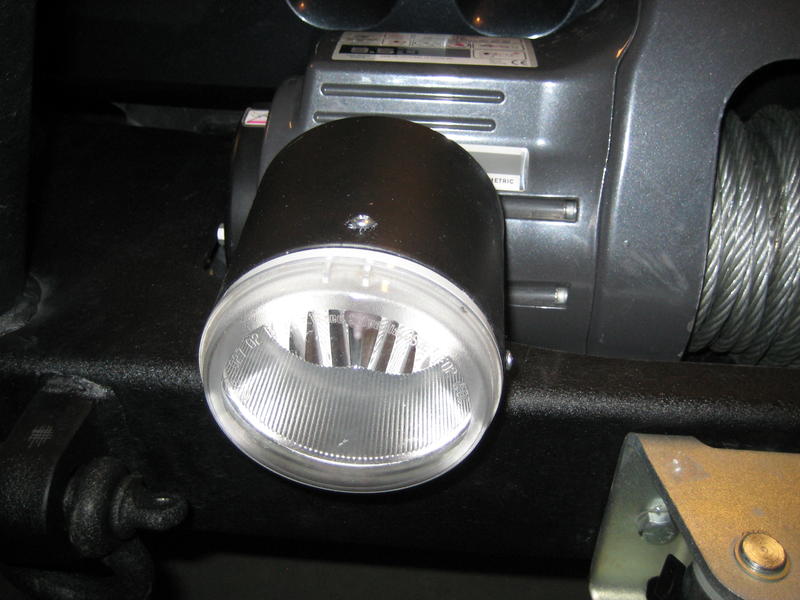

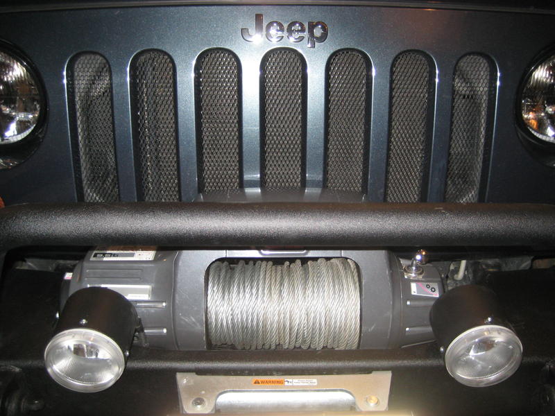

I re-used the factory foglights with some 3" pvc and they work great!
ID:	214428Click image for larger version
Attachment 214428Attachment 214429
Hello
You have anymore pic of your lights? I beleive Iam going to do that. I would like to see how you insert it in pvc and take a look at back part of light. Will you explain how you did it and what was use to mount it also.
GREAT IDEAL!!
Thanks
Old Sep 30, 2011 | 08:23 PM
ZombJep's Avatar
Joined: Apr 2010
Posts: 503
From: Riverside, CA
Originally Posted by Coltbuntline
Hello
GREAT IDEAL!!
Thanks
Unfortunately I don't have any other pics. It's pretty easy though. Just take your fog lights out of the black plastic casing. Take the fog light with you to your local hardware store to make sure you get the right size pvc pipe. There are some little plastic tabs around the edges that you have to grind off in order for it to fit flush. You can use a dremel or sandpaper. Paint the pvc with some spray paint (make sure you rough up the pvc first or the paint won't stick). Put the fog light in and put 3 small screws in around the edges (make sure they are short enough to not poke through). Put a bolt through the bottom to go into your bumper. Plug 'em in and your good to go. Sorry I couldn't get better pics but then I would have to go take them apart and I'm too lazy. It's really easy and it helps with the dismal JK lighting. as far as the back goes it is just the open end of the pvc. Not weather proof at all but shouldn't be a problem.
