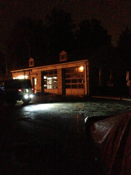

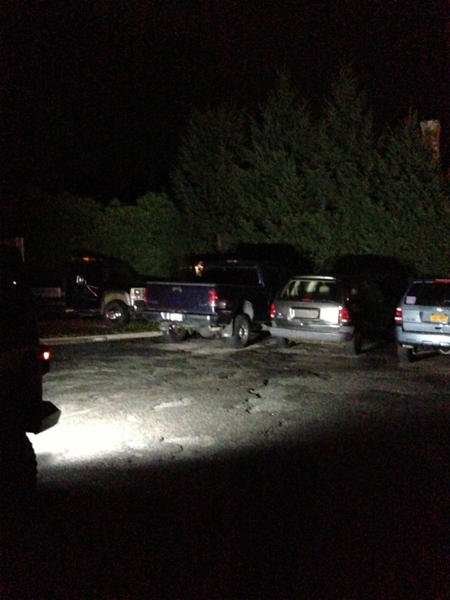

I have the rigid dually's diffused flush mount in my Lod read.
ID:	483588   Click image for larger version
