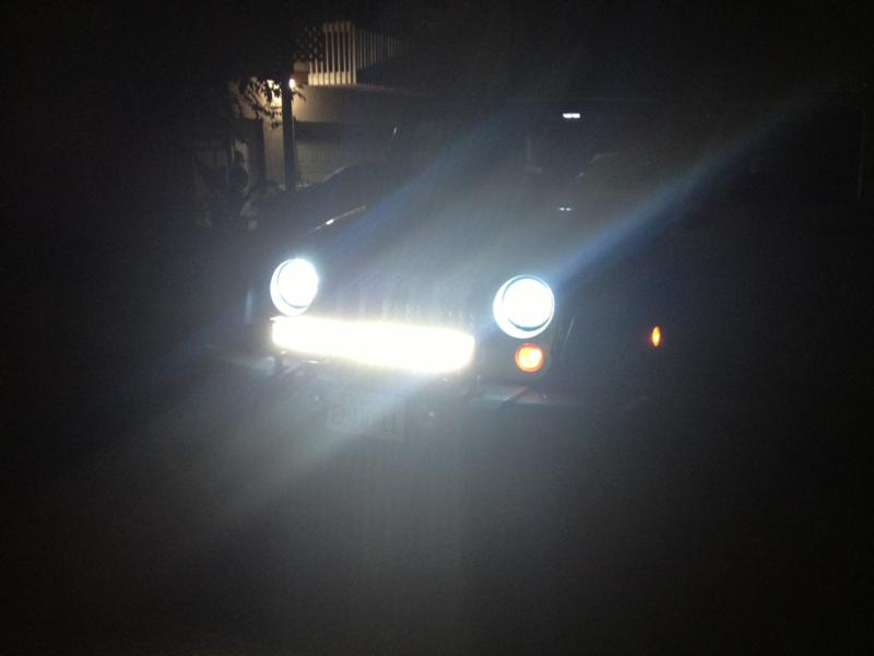

Anything after market can NOT be used in city roads unless totally empty so yell have this issue anyways so just pick some lights install them and be causes were you use them
I have HID HI/LOW
And a 30" LED light bar as you can see on my picture

I have HID's as my headlights and if needed I have a 30" LED bar and between the two when I drive out on a camping trail I have no problem
