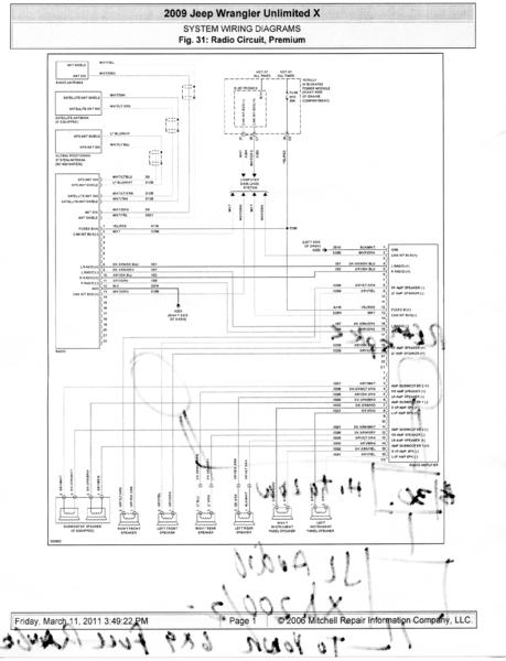

I hope the attachment works
So now I go to another installer and he shows me this wiring diagram and states that if you want to keep the factory head unit you cant just replace the infinity amp with the PDX5. This guy says I will also need an MTX re-Q5 to make it work properly. This thing is another 100+ bucks. Is this correct?
