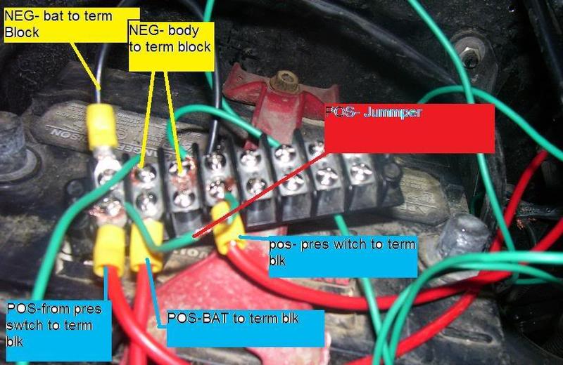

x2^^^^ I was going to suggest this, or add a terminal block and you can attach several accessories to individual connections instead of just one on the post (grabbed pic from other site).
