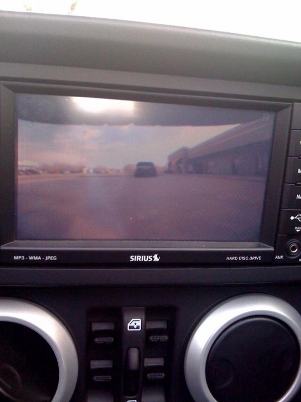

Can you post pix of the camera and what it looks like on your screen in reverse (assuming you have no other way to turn the camera on othe than being in reverse)?
Old Mar 18, 2009 | 06:35 AM
JayhawkJK's Avatar
Joined: Nov 2007
Posts: 74
From: Derby, KS
Here are the pics you asked for. Sorry for the quality, it's a cell phone. The mygig screen looks hazy because the top is off and it is sunny out. I hope this helps.
BTW-the camera only shows up on the screen when in reverse.

Old Mar 18, 2009 | 07:30 AM
Skippman's Avatar
Joined: Nov 2008
Posts: 1,680
Likes: 6
From: St. Louis, MO
Cool! I dunno if that will work for me as I'm planning to replace my rear bumper with the MOPAR steel one but it looks very nice on yours. Good place for the Sahara owners.
