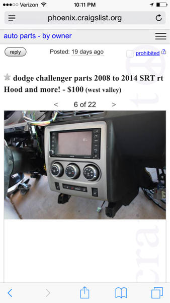

Would a nav off of an 07 magnum fit/work with a 13 JKU? Click image for larger version

Default Wrong Canbus speed
No, a Magnum nav will not work. Magnum's use a low speed canbus system, Wrangler's use a high speed. Use the website below to see which vehicles have high speed. Any high speed system will work in the JK. The most readily available (and cheapest I found) were from Chrysler Town and Country mini-vans.

Thank you!!! Glad I didn't buy it!
