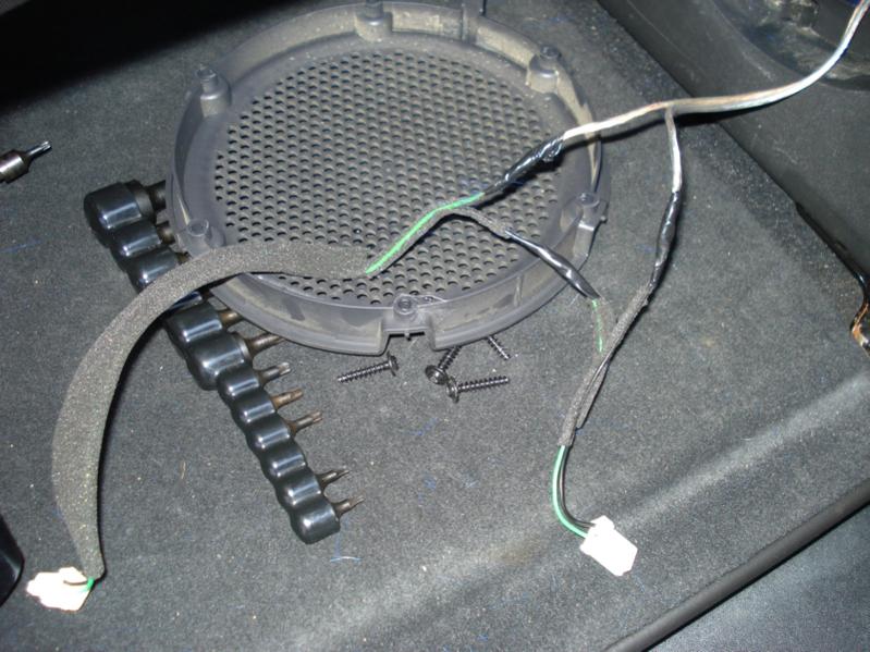

You are right, duel 2 ohm sub. Depending on the amp you are using will determine correct wiring. The sub can only draw a 4 ohm or 1 ohm load. Running speaker wires in "series" as shown in picture will pull a 4 ohm load, most amps can handle this. Does not take much to max this little sub out. Good luck

Perfect Picture of the 2 ohm voice coil
You could also wire each channel up seperately and run the dual 2-ohm with a 2 channel amp. So options are: 4 ohm (series), 1 ohm (parallel), and 2X 2 Ohms. Rather versatile. Make sure the amp can handle the 1 ohm load, if you choose this route. I know my aftermarket amp could not, and ran it with the 2X 2 ohm setup.
