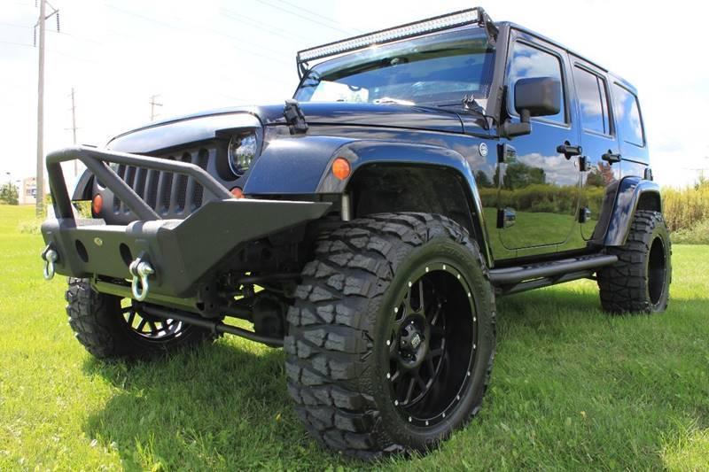

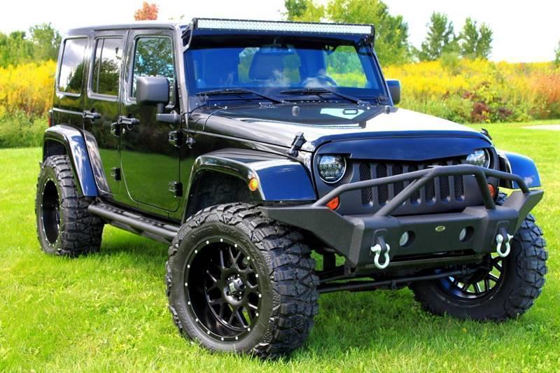

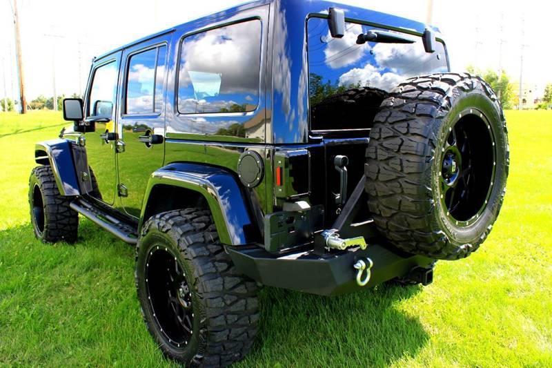

Any input would be very helpful! Thanks guys, attached below are pics of my new Jeep!!
