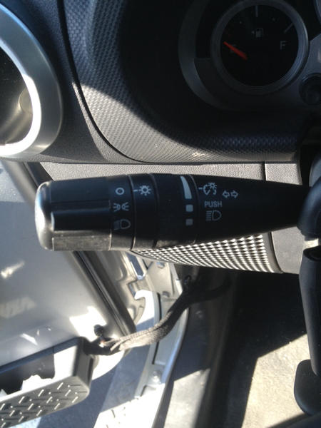

I will, and I will post them asap. I do know though, there is no fog light icon where I know it should be on the end that pulls out. Leads me to believe the wrong stalk is on there.

Picture is attached. Thanks
