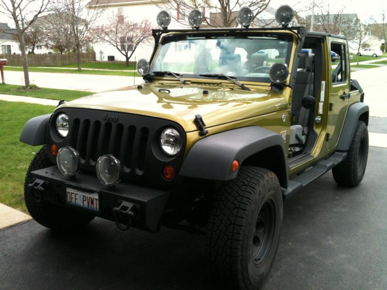

Old Jun 7, 2011 | 01:34 PM
Orangeav's Avatar
Posts: 1,651
From: Montgomery, Il
Originally Posted by xerofall
Yes... you need at least 10 lights.
Hey, that looks pretty good... Not that I'm biased to the color or lights... Lol!
...poser shot is all I have on my phone!
I wouldn't bother cutting into your factory wiring, get a switch pod from RR and it will look fine!
