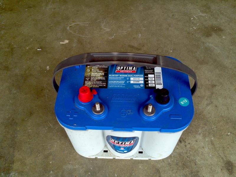

I've got a yellow top in mine and a blue top new sitting in the garage (d34m) which is the same as yellow but has to thread style mounts on top as well as top mounts so hooking up a winch directly to its own mount is easy....and it has a blue top no front mounts, still deep cycle, 750 CCA, starting battery.
I hear the die hard platinum is a gold battery as well if you end up options a get a d34m blue, you will have the standard top post and a thread post for the winch direct to battery with no additional wires...cleaner looking.
Attachment 513593
Attachment 513593

You had me at cleaner looking!
Just in time too! I was going to buy a new battery during the wiring I have to do. I was going to use a Yellow Top like I usually do, but now I'm going to use a Blue top instead. I've used Yellow tops for years. In my S2000 show car we used the same Yellow top for about 10years. We would run that poor thing down show after show. We'd jump the car to start it at the end of every show to drive home. It would recharge during the drive home and it would be all set.
