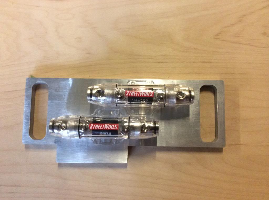

I took a break from the wood working this afternoon to mill out a under hood fuse holder out of half inch aluminum. This will hold the Big 3 alternator fuse and the stereo system fuse.
