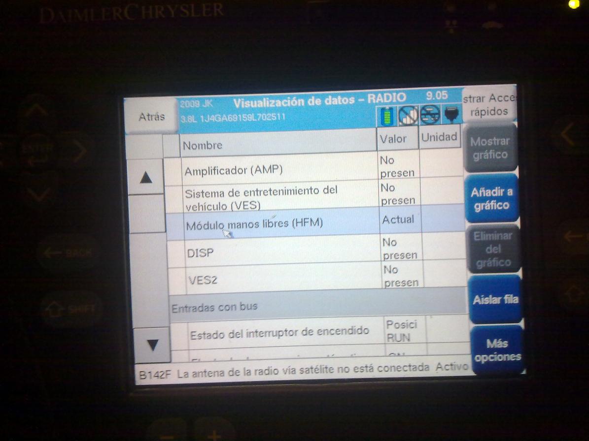

Originally Posted by Octo
I have the detail steps on my old hard drive which is locked up at work, but basically if you go through the various menus on the Star Scan you should find one entitles HFM (Hands Free Module) Gateway or something to that affect. I think it was as simple selecting it.
We already do that but not works to me
some recommendation?
