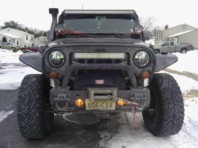

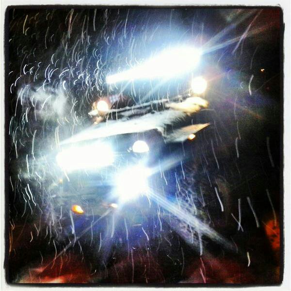

But I got them for offroad purposes
-20" dual pattern- throws light a good distance and spreads the light out
-50" dual pattern- throws light really far and wide due to its high mounting point (nearly triples the output to the brightness had by my 20")
-(3)Blitzpro Hawk 6D driving pattern lights- (2) mounted on corners of front bumper at 45 degree angles to throw light to the sides of the trail. (1) mounted facing rearward on my Jerry can carrier for some light out back
- PIAA 520 Series lights with ion yellow bulbs mounted on the windshield. I pretty much use these when it snows, amber light makes it easier to see in fog, dust, snow, and heavy rain
-Gen2 Trucklite headlights-hell of a lot better than stock
Sent from my obama monitoring device

Thank you! All my lights are wired separately. 50/bumper lights (20" & (2) Blitzpro)/ rear Blitzpro/ 2 piaas
I have then on 4 switches. Think I miss go to 5 switches tho and add two more Blitzpro on rear corners at angles and have the 4 corner lights on their own switch. And the antenna is a 5' Firestik 2 on a 3" spring

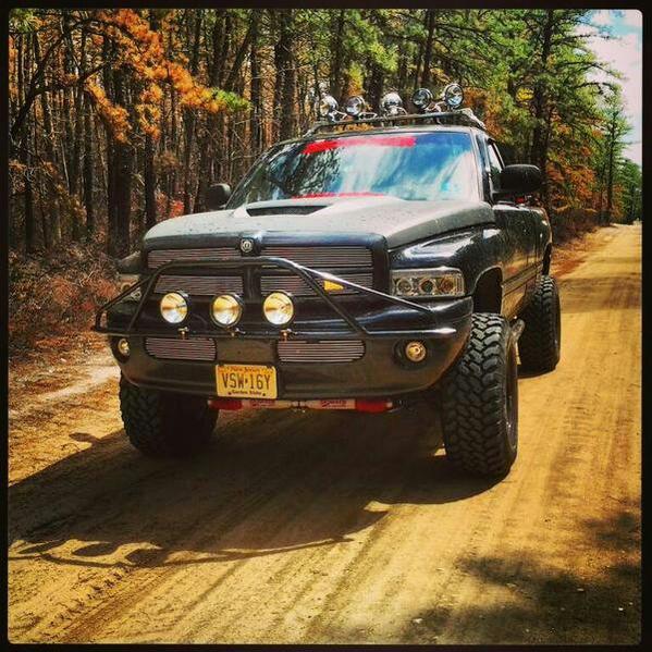

And u were asking about all lights. I also had (8) 130watt KC daylighters on my old ram, some spot and some flood. This long range kcs definitely shoot light a lot farther than any led bar I've ever seen but where I live that does me no good really, great for the desert tho... The floods are great but don't appear light like the leds.... that's why I went with leds this time around.

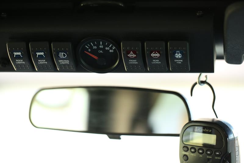

All aftermarket lights on the front are tied into the sPOD, which is connected to the auxiliary battery ...

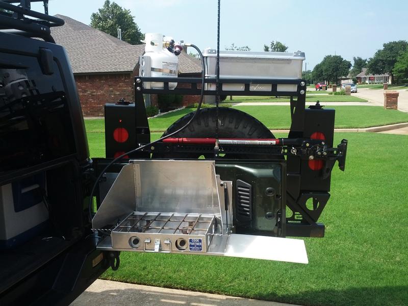

Almost. I still need to provide some lighting around my rear area, which is a kitchen. I'm reworking that entire area to put in a fridge slide and drawer and rack to hold the Alu-Boxes that now go on the overhead rack--better to move as much weight down as possible. Thinking I'll use LED rope lights in this area, but we'll see as things develop.
