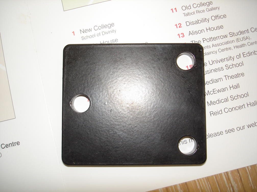

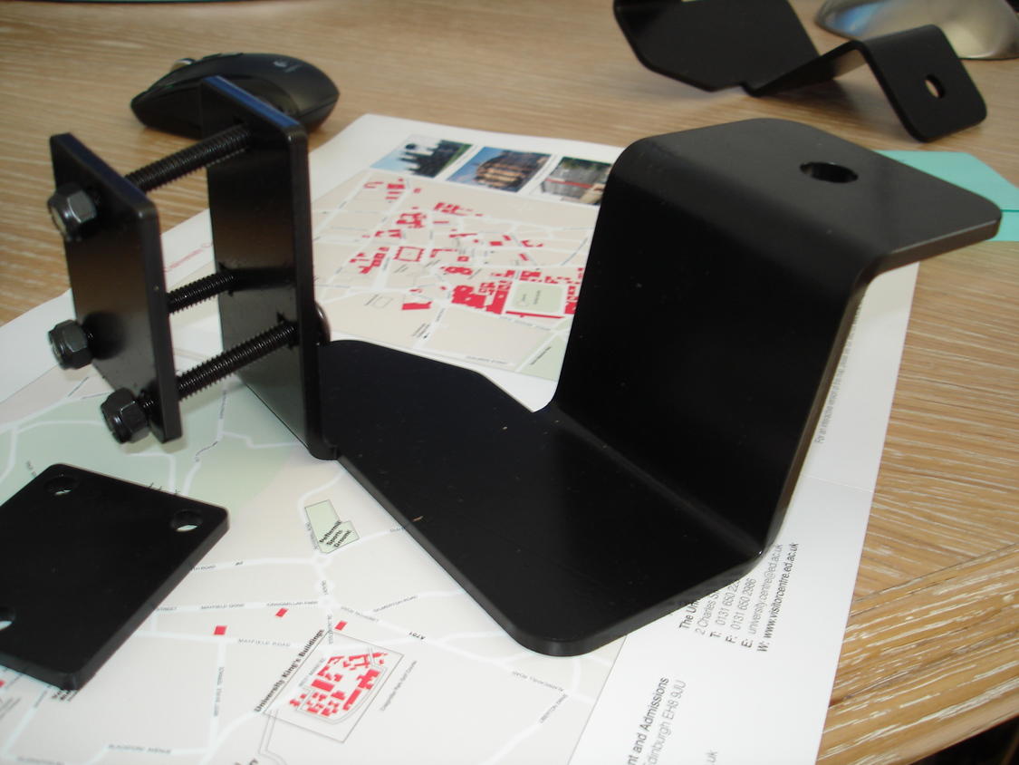

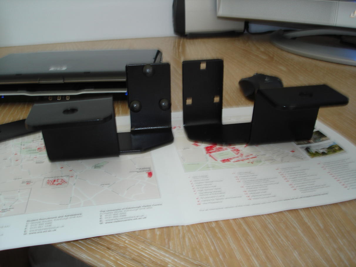

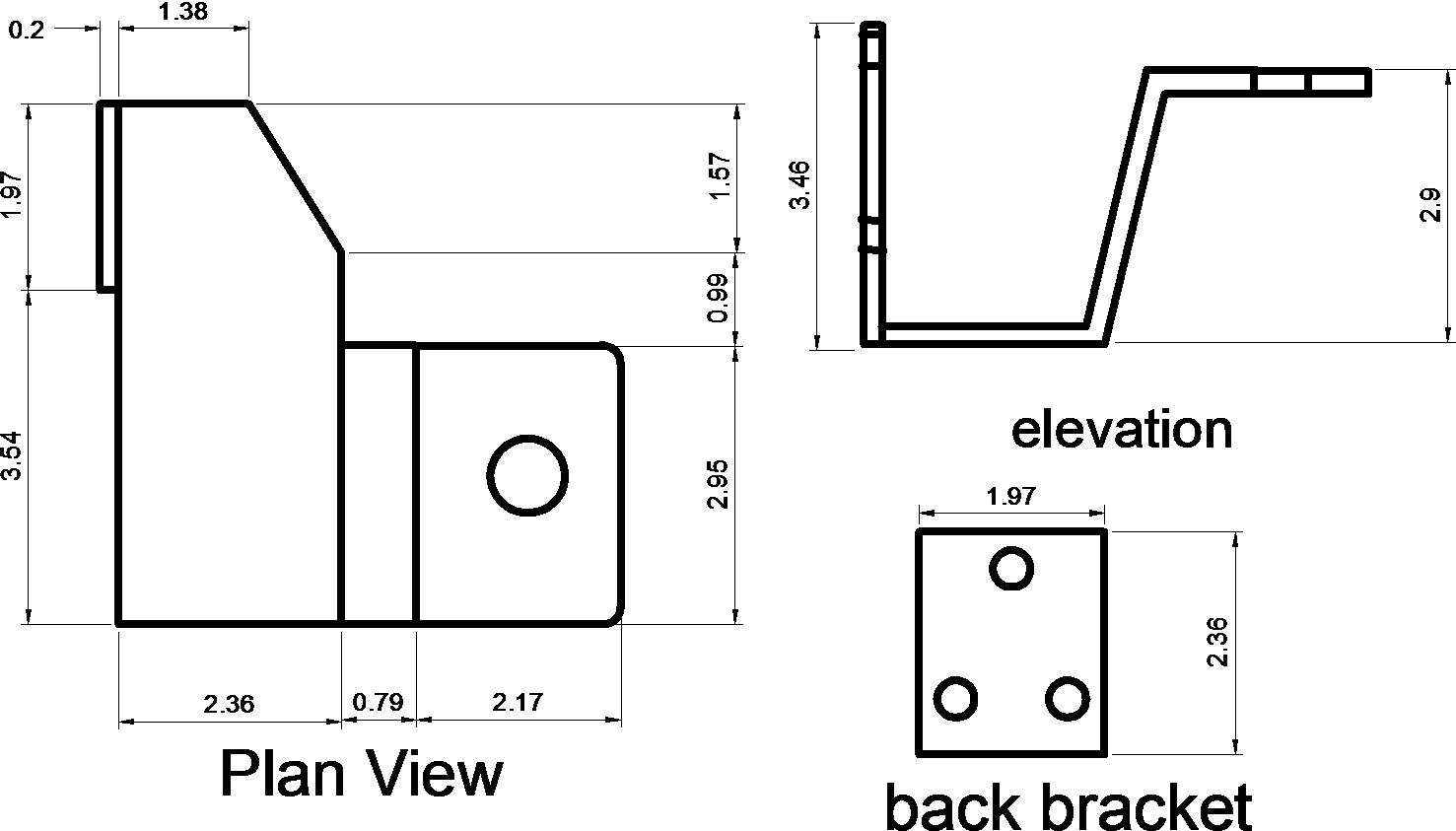

if you have a pair not installed yet could you do a rough blueprint of them?

no prob. is this clear enough? the two brackets are not indentical but they are sort of a mirror image as shown

BIG Thanks man.. that is exactly what i was looking for..
Are the measurements the in inches?

your welcome.... yeah i converted them, i usually work in mm but i thought you guys would apreciate inches. btw they are not 100% accurate but i would say they are near enough to get something made (96%).
