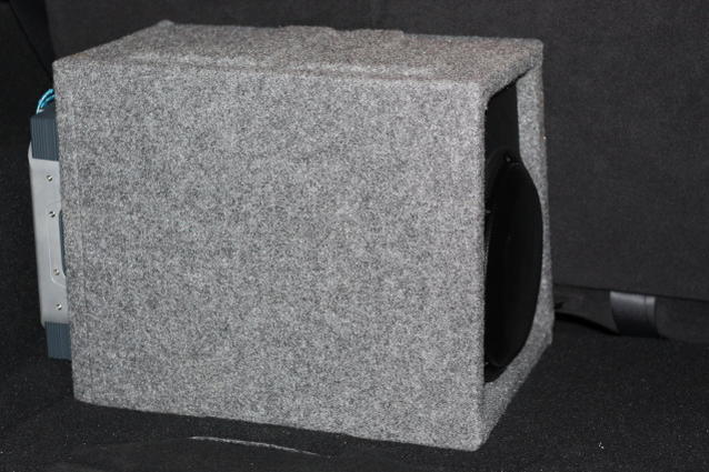

[IMG]box resize.jpg[/IMG]
I made this box for a JL audio 10" sub, and it kicks, all the power wires are made to quick disconnect, I took out the old sub, in its place we mounted a Rockford Fosgate amp. We looked at several options at the audio store and this seemed to be the easiest, better than the Infinity bass link.
