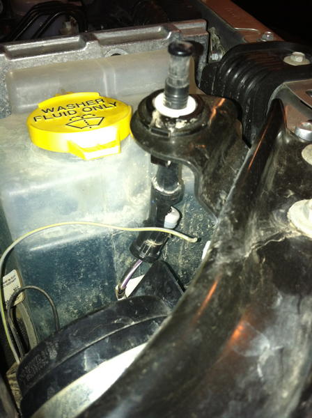

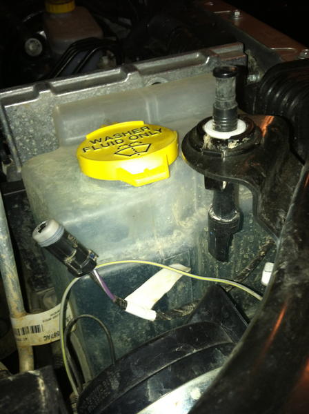

Is there a way to bypass this hood switch?
Or do I have to see if Jeep can order me a new one?
The problem is that one of the 2 little prongs that are in the plug is broke off in the female end.
What can I do?!

I dont know what that random green wire goes to in the pics.....its not to the switch though....
I think it may go to the horn...

Looks like a pretty simple circuit. When plunger is down it completes the circuit, when plunger is up (hood open) it breaks the circuit. You could just defeat the safety switch by inserting a jumper wire at the connector until you can get it repaired.

Excellent! Thanks!
