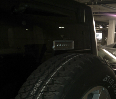

I also got a black LED 3rd light replacement from http://www.inprocarwear.com/ (bought it on Ebay for 100$)
