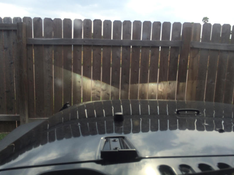

I'm going to have re clock the left light because it's turned a little

Looks like both are turned

I have always been under the impression that they should have a little angle to them and that's what the difference is between LHD and RHD projectors

No. See where the line angles up then flattens again. That's where the LHD and RHD come from. The higher point is on the passenger side since we drive on the right side of the rd you don't want to blind drivers on the left side as they pass you. Go in a rhd and in Europe where everything is flopped created the need for the rhd projector to reverse the pattern.
Best way I know how to explain it and it's all speculation. Lol
