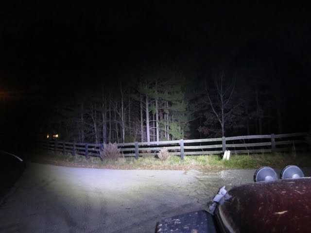

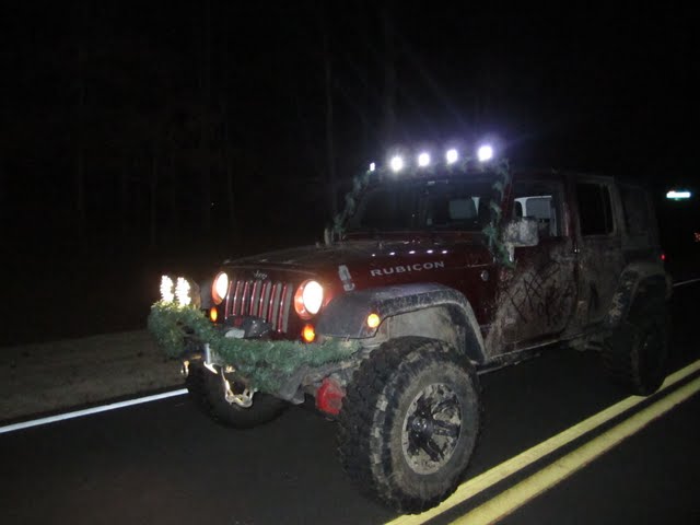

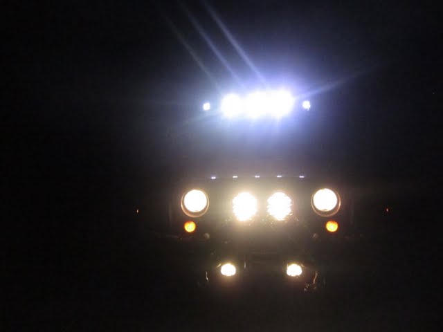

5 Dually LEDs on a Rugged Ridge light bar
My reasons for going this route:
- Wanted a lower profile light as opposed to 6 or 7" round.
- Wanted a lower power solution to keep a single circuit. Traditional Halogens at 55W or more per light would have required several independent circuits and wire runs through the light bar or a much larger wire - 25Amps at 10 to 15 feet: 12 or even 10 Gauge).
- Wanted enough light to light up a trail, wasn't looking for 1/2 mile beams.
3 floods, 2 spots: [flood] [spot] [flood] [spot] [flood]
The 2 floods on the outside are angled slightly to the sides
Attachment 112195
Attachment 112196
Attachment 112197
This is just the LEDs on:
Attachment 112198
I can say these lights are *solid* - the housing is very durable - have no doubts these this will stand up to any beating. I plan to mount 2 more floods in the back.
I have the same setup as you and I having trouble trying to decide how to wire them. Did you run the cables through the inside of the bar? And if so how did you it the plug-n-play harness through the small hole? I would really appreciate some help and pictures of how you did this. Thanks a lot!
